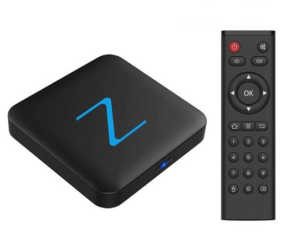

z11 pro
FDT=/dtb/amlogic/meson-gxl-s905x-khadas-vim.dtb
