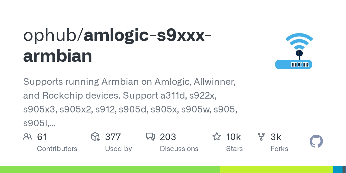

Eu fiz com disse o “ophub”
https://github.com/ophub/amlogic-s9xxx-armbian/issues/644
