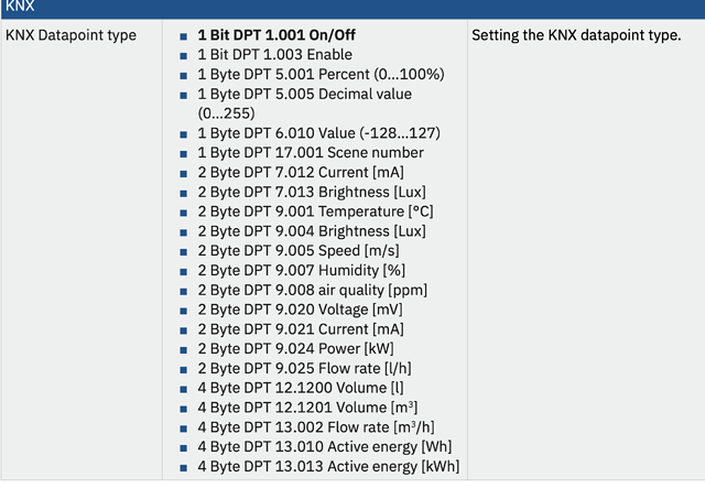

The channels have consecutive register addresses (address “+1” for Modbus data types
“1 Byte/2 Byte”. Address “+2” for Modbus data type “4 Byte”).
no caso da edpbox seria sempre +1.
