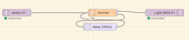

No node red é que os interruptores do IKEA deixaram de funcionar, excepto 2 que comandam lampadas do IKEA.
Não sei como colocar só os nodes, por isso coloco o código, deste que funciona.
        "id": "e661bd09edf39f2c",
        "type": "mqtt out",
        "z": "dd03271087cc52af",
        "name": "Light IKEA 01",
        "topic": "zigbee2mqtt/Generic Dimmable Light IKEA 01/set",
        "qos": "",
        "retain": "",
        "respTopic": "",
        "contentType": "",
        "userProps": "",
        "correl": "",
        "expiry": "",
        "broker": "eca6af44.5297b",
        "x": 700,
        "y": 940,
        "wires": []
        "id": "5b3be5ae528e42e8",
        "type": "mqtt in",
        "name": "switch 01",
        "topic": "zigbee2mqtt/IKEA switch 01",
        "qos": "2",
        "datatype": "json",
        "nl": false,
        "rap": false,
        "inputs": 0,
        "x": 80,
        "y": 940,
        "wires": [
                "35f317525a529ef2"
        "id": "35f317525a529ef2",
        "type": "function",
        "name": "Dimmer",
        "func": "/*\n    This function currently works with IKEA models:\n        E1743 TRADFRI On/Off Switch\n        E1810 TRADFRI Remote\n\n\n    msg.payload.action:\n    \n        From E1743 TRADFRI On/Off Switch\n            on\n            off\n            brightness_move_down\n            brightness_move_up\n            brightness_stop\n        \n        From E1810 TRADFRI Remote    \n            toggle (there is no on/off)\n            brightness_up_click\n            brightness_up_hold\n            brightness_up_release\n            brightness_down_click\n            brightness_down_hold\n            brightness_down_release\n\n\n*/\n\nvar step = 16;      // change in brightness for each step.\nvar loopLimit = 30; // max number of loops. Safety in case we don't get a brightness_stop action.\n\nvar brightness = context.get(\"brightness\") || 128;\nvar repeating  = context.get(\"repeating\") || 0;\nvar out = null;       // output #1, to zigbee2mqtt\nvar outLoop = null; // output #2, to a delay, and back to the input.\n\n\nfunction setBrightness(dir) {\n    if(dir > 0) {\n        brightness += step;\n    } else {\n        brightness -= step;\n    }\n    if(brightness <= 2) {brightness = 2;}  // 1 and 0 are off\n    if(brightness >=255) {brightness = 255;}\n    out = {\"payload\": {\"state\": \"on\", \"brightness\": brightness}};\n}\n\nif(msg.payload.action == \"on\") {\n    out = {\"payload\": {\"state\": \"on\"}};\n} else if(msg.payload.action == \"off\") {\n    out = {\"payload\": {\"state\": \"off\"}};\n} else if(msg.payload.action == \"toggle\") {\n    out = {\"payload\": {\"state\": \"toggle\"}};\n\n} else if(msg.payload.action == \"brightness_up_click\") {\n    setBrightness(+1);\n} else if(msg.payload.action == \"brightness_down_click\") {\n    setBrightness(-1);\n\n} else if(msg.payload.action == \"brightness_move_up\" ||\n        msg.payload.action == \"brightness_up_hold\" ||\n        (msg.payload.action == \"brightness_up_rep\" && repeating) ) {\n    setBrightness(+1);\n    outLoop = {\"payload\": {\"action\": \"brightness_up_rep\"}};\n    repeating++;\n} else if(msg.payload.action == \"brightness_move_down\" ||\n        msg.payload.action == \"brightness_down_hold\" ||\n        (msg.payload.action == \"brightness_down_rep\" && repeating) ) {\n    setBrightness(-1);\n    outLoop = {\"payload\": {\"action\": \"brightness_down_rep\"}};\n    repeating++;\n    \n} else if(msg.payload.action == \"brightness_stop\" ||\n        msg.payload.action == \"brightness_up_release\" ||\n        msg.payload.action == \"brightness_down_release\" ||\n        repeating > loopLimit) {\n    repeating = 0;\n\n}\n\ncontext.set(\"brightness\", brightness);\ncontext.set(\"repeating\", repeating);\nnode.status({text:brightness});\n\nreturn [out, outLoop];\n",
        "outputs": 2,
        "noerr": 0,
        "initialize": "",
        "finalize": "",
        "libs": [],
        "x": 440,
        "y": 940,
        "wires": [
                "e661bd09edf39f2c"
                "435f8d57cec39f3f"
        "id": "435f8d57cec39f3f",
        "type": "delay",
        "name": "",
        "pauseType": "delay",
        "timeout": "250",
        "timeoutUnits": "milliseconds",
        "rate": "1",
        "nbRateUnits": "1",
        "rateUnits": "second",
        "randomFirst": "1",
        "randomLast": "5",
        "randomUnits": "seconds",
        "drop": false,
        "outputs": 1,
        "x": 430,
        "y": 1000,
        "wires": [
                "35f317525a529ef2"
