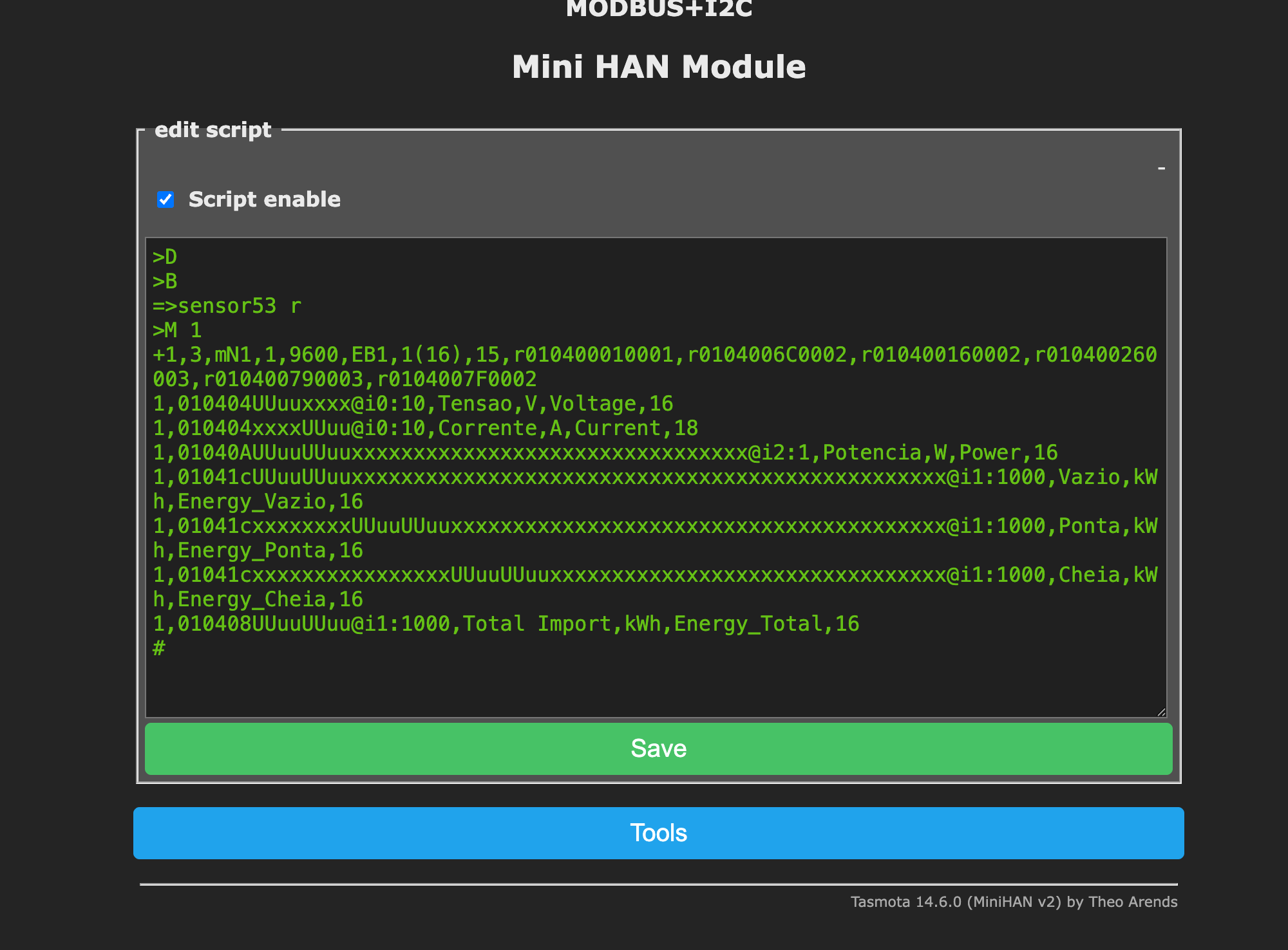

o script que tenho neste momento:
>D
>B
=>sensor53 r
>M 1
+1,3,mN1,1,9600,EB1,16,15,r010400010001,r0104006C0002,r010400160002,r010400260003,r010400790003,r0104007F0002
1,010404UUuuxxxx@i0:10,Tensao,V,Voltage,16
1,010404xxxxUUuu@i0:10,Corrente,A,Current,18
1,01040AUUuuUUuuxxxxxxxxxxxxxxxxxxxxxxxxxxxxxxxx@i2:1,Potencia,W,Power,16
1,01041cUUuuUUuuxxxxxxxxxxxxxxxxxxxxxxxxxxxxxxxxxxxxxxxxxxxxxxxx@i1:1000,Vazio,kWh,Energy_Vazio,16
1,01041cxxxxxxxxUUuuUUuuxxxxxxxxxxxxxxxxxxxxxxxxxxxxxxxxxxxxxxxx@i1:1000,Ponta,kWh,Energy_Ponta,16
1,01041cxxxxxxxxxxxxxxxxUUuuUUuuxxxxxxxxxxxxxxxxxxxxxxxxxxxxxxxx@i1:1000,Cheia,kWh,Energy_Cheia,16
1,010408UUuuUUuu@i1:1000,Total Import,kWh,Energy_Total,16
+1,3,mN1,1,9600,EB1,16,15,...
+1,3,mN1,1,9600,EB1,1(16),15,...
Onde tens 16 mete 1(16)

Isso já está a funcionar.
Consola: Sensor53 d0

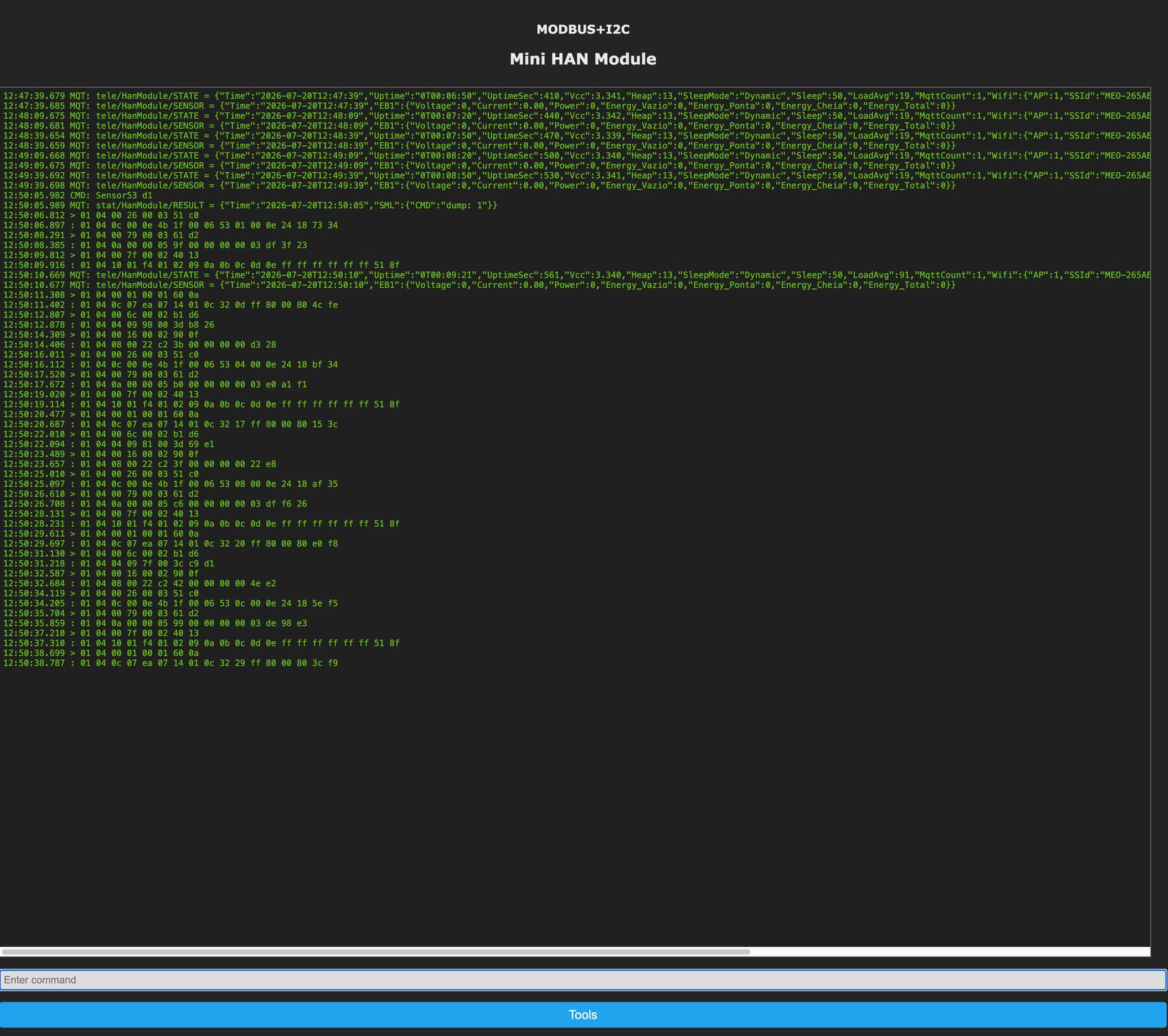

Resolvi um problema e apareceu-me outro, estava tudo a funcionar ok mas hoje deparei com outro problema.
Agora os dados aparece-me todos a 0
isto é o que me aparece na consola, como resolver?
22:25:11.268 MQT: tele/HanModule_F41FC4/SENSOR = {"Time":"2026-07-27T22:25:11","9600":{"Year":0,"Month":0,"Day":0,"CH":0,"CM":0,"CS":0,"V1":0.0,"I1":0.0,"Pi":0,"Pe":0,"PF":0.000,"F":0.0,"ET1":0.0,"ET2":0.0,"ET3":0.0,"Ei":0.000,"Ee":0.000,"Tarif":0,"ConT1":0.00,"ConT2":0.00,"ConT3":0.00,"DCP":0,"Q":0,"K":0.0},"daily_consumption":0.00,"daily_feed":0.00}
22:25:41.226 MQT: tele/HanModule_F41FC4/STATE = {"Time":"2026-07-27T22:25:41","Uptime":"0T00:05:10","UptimeSec":310,"Vcc":3.268,"Heap":12,"SleepMode":"Dynamic","Sleep":50,"LoadAvg":19,"MqttCount":1,"Wifi":{"AP":1,"SSId":"IDIoT","BSSId":"8A:22:54:29:93:2B","Channel":9,"Mode":"11n","RSSI":64,"Signal":-68,"LinkCount":1,"Downtime":"0T00:00:04"}}
22:25:41.241 MQT: tele/HanModule_F41FC4/SENSOR = {"Time":"2026-07-27T22:25:41","9600":{"Year":0,"Month":0,"Day":0,"CH":0,"CM":0,"CS":0,"V1":0.0,"I1":0.0,"Pi":0,"Pe":0,"PF":0.000,"F":0.0,"ET1":0.0,"ET2":0.0,"ET3":0.0,"Ei":0.000,"Ee":0.000,"Tarif":0,"ConT1":0.00,"ConT2":0.00,"ConT3":0.00,"DCP":0,"Q":0,"K":0.0},"daily_consumption":0.00,"daily_feed":0.00}
22:26:11.241 MQT: tele/HanModule_F41FC4/STATE = {"Time":"2026-07-27T22:26:11","Uptime":"0T00:05:40","UptimeSec":340,"Vcc":3.268,"Heap":12,"SleepMode":"Dynamic","Sleep":50,"LoadAvg":19,"MqttCount":1,"Wifi":{"AP":1,"SSId":"IDIoT","BSSId":"8A:22:54:29:93:2B","Channel":9,"Mode":"11n","RSSI":64,"Signal":-68,"LinkCount":1,"Downtime":"0T00:00:04"}}
22:26:11.254 MQT: tele/HanModule_F41FC4/SENSOR = {"Time":"2026-07-27T22:26:11","9600":{"Year":0,"Month":0,"Day":0,"CH":0,"CM":0,"CS":0,"V1":0.0,"I1":0.0,"Pi":0,"Pe":0,"PF":0.000,"F":0.0,"ET1":0.0,"ET2":0.0,"ET3":0.0,"Ei":0.000,"Ee":0.000,"Tarif":0,"ConT1":0.00,"ConT2":0.00,"ConT3":0.00,"DCP":0,"Q":0,"K":0.0},"daily_consumption":0.00,"daily_feed":0.00}
22:26:27.768 SCR: nv=7, tv=0, vns=32, vmem=139, smem=8192, gmem=388, tmem=8751
22:26:27.772 SCR: performs "sensor53 r"
22:26:27.782 SNS: Hardware Serial
22:26:27.784 meters: 1 , decode lines: 24, memory used: 3175 bytes
22:26:27.789 MQT: stat/HanModule_F41FC4/RESULT = {"Time":"2026-07-27T22:26:27","SML":{"CMD":"restart"}}
22:26:41.253 MQT: tele/HanModule_F41FC4/STATE = {"Time":"2026-07-27T22:26:41","Uptime":"0T00:06:10","UptimeSec":370,"Vcc":3.270,"Heap":12,"SleepMode":"Dynamic","Sleep":50,"LoadAvg":27,"MqttCount":1,"Wifi":{"AP":1,"SSId":"IDIoT","BSSId":"8A:22:54:29:93:2B","Channel":9,"Mode":"11n","RSSI":64,"Signal":-68,"LinkCount":1,"Downtime":"0T00:00:04"}}
22:26:41.262 MQT: tele/HanModule_F41FC4/SENSOR = {"Time":"2026-07-27T22:26:41","daily_consumption":0.00,"daily_feed":0.00}
22:27:11.233 MQT: tele/HanModule_F41FC4/STATE = {"Time":"2026-07-27T22:27:11","Uptime":"0T00:06:40","UptimeSec":400,"Vcc":3.268,"Heap":12,"SleepMode":"Dynamic","Sleep":50,"LoadAvg":25,"MqttCount":1,"Wifi":{"AP":1,"SSId":"IDIoT","BSSId":"8A:22:54:29:93:2B","Channel":9,"Mode":"11n","RSSI":62,"Signal":-69,"LinkCount":1,"Downtime":"0T00:00:04"}}
22:27:11.242 MQT: tele/HanModule_F41FC4/SENSOR = {"Time":"2026-07-27T22:27:11","daily_consumption":0.00,"daily_feed":0.00}
22:27:41.250 MQT: tele/HanModule_F41FC4/STATE = {"Time":"2026-07-27T22:27:41","Uptime":"0T00:07:10","UptimeSec":430,"Vcc":3.271,"Heap":12,"SleepMode":"Dynamic","Sleep":50,"LoadAvg":19,"MqttCount":1,"Wifi":{"AP":1,"SSId":"IDIoT","BSSId":"8A:22:54:29:93:2B","Channel":9,"Mode":"11n","RSSI":64,"Signal":-68,"LinkCount":1,"Downtime":"0T00:00:04"}}
22:27:41.259 MQT: tele/HanModule_F41FC4/SENSOR = {"Time":"2026-07-27T22:27:41","daily_consumption":0.00,"daily_feed":0.00}
22:28:12.226 MQT: tele/HanModule_F41FC4/STATE = {"Time":"2026-07-27T22:28:12","Uptime":"0T00:07:41","UptimeSec":461,"Vcc":3.268,"Heap":12,"SleepMode":"Dynamic","Sleep":50,"LoadAvg":45,"MqttCount":1,"Wifi":{"AP":1,"SSId":"IDIoT","BSSId":"8A:22:54:29:93:2B","Channel":9,"Mode":"11n","RSSI":64,"Signal":-68,"LinkCount":1,"Downtime":"0T00:00:04"}}
22:28:12.235 MQT: tele/HanModule_F41FC4/SENSOR = {"Time":"2026-07-27T22:28:12","daily_consumption":0.00,"daily_feed":0.00}
Consegues ver a msg anterior?
