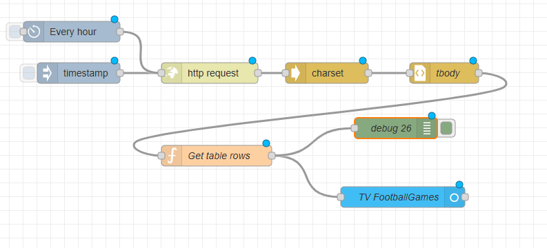

Flow a importar para o Node Red:
(devem configurar os nodes necessários de forma a executarem o flow e criar o sensor no Home Assistant)
[{"id":"30ee198fc9087217","type":"tab","label":"Futebol","disabled":false,"info":"","env":[]},{"id":"e01a42f439c105e8","type":"inject","z":"30ee198fc9087217","name":"","props":[{"p":"payload"},{"p":"topic","vt":"str"}],"repeat":"","crontab":"","once":false,"onceDelay":0.1,"topic":"","payload":"","payloadType":"date","x":120,"y":160,"wires":[["ac7e9165fbb8182e"]]},{"id":"ac7e9165fbb8182e","type":"http request","z":"30ee198fc9087217","name":"","method":"GET","ret":"bin","paytoqs":"ignore","url":"https://www.zerozero.pt/zapping","tls":"","persist":false,"proxy":"","insecureHTTPParser":false,"authType":"","senderr":false,"headers":[],"x":290,"y":160,"wires":[["e9e914a8d34f99f7"]]},{"id":"e9e914a8d34f99f7","type":"converter","z":"30ee198fc9087217","name":"","from":"ISO-8859-1","x":460,"y":160,"wires":[["2162710daca98e23"]]},{"id":"bb49728e0dd5d749","type":"debug","z":"30ee198fc9087217","name":"debug 12","active":true,"tosidebar":true,"console":false,"tostatus":false,"complete":"false","statusVal":"","statusType":"auto","x":1160,"y":160,"wires":[]},{"id":"2162710daca98e23","type":"html","z":"30ee198fc9087217","name":"tbody","property":"payload","outproperty":"payload","tag":"#page_main > div:nth-child(2) > table > tbody","ret":"html","as":"single","x":610,"y":160,"wires":[["01ecd02c959eaef3"]]},{"id":"01ecd02c959eaef3","type":"function","z":"30ee198fc9087217","name":"Get table rows","func":"let allRows = [];\nlet html = msg.payload[0];\nlet htmlToParse = html;\n\nwhile(htmlToParse.indexOf(\"<tr>\") > -1 && htmlToParse.indexOf(\"</tr>\") > -1) {\n    let currentRow = htmlToParse.substring(4, htmlToParse.indexOf(\"</tr>\"));\n\n   allRows.push( {\n       'row': currentRow,\n   });\n   htmlToParse = htmlToParse.substring(htmlToParse.indexOf(\"</tr>\")+5, htmlToParse.length);\n} \n\n\nreturn [{\n    'payload': \n    {\n        'allRows': allRows\n    }\n}, null];","outputs":1,"timeout":0,"noerr":0,"initialize":"","finalize":"","libs":[],"x":780,"y":160,"wires":[["a52ede8c0bbbfc24"]]},{"id":"a52ede8c0bbbfc24","type":"function","z":"30ee198fc9087217","name":"Get all games","func":"let allRows = msg.payload.allRows;\nlet games = [];\n\nlet remainingRow = null;\nlet urlBase = \"https://www.zerozero.pt\";\n\nvar date = new Date();\nvar dateStr =\n date.getFullYear()+ \"-\" +\n  (\"00\" + (date.getMonth() + 1)).slice(-2) + \"-\" +\n   (\"00\" + date.getDate()).slice(-2)  + \" \" +\n  (\"00\" + date.getHours()).slice(-2) + \":\" +\n  (\"00\" + date.getMinutes()).slice(-2) + \":\" +\n  (\"00\" + date.getSeconds()).slice(-2);\n\n\n\n\nfor (var i = 0; i < allRows.length; i++) {\n\n let row = allRows[i].row;\n    let game = {\n        'date'              : '',\n        'time'              : '',\n        'transmissionType'  : '',\n        'country'           : '',\n        'countryIcon'       : '',\n        'division'          : '',\n        'homeTeamName'      : '',\n        'homeTeamIcon'      : '',\n        'awayTeamName'      : '',\n        'awayTeamIcon'      : '',\n        'channel'           : '',\n        'channelIcon'       : '',\n        'channelLink'       : '',\n        'competitionName'   : ''\n    };\n\n    if (game.date == '') {\n        let gameTime = row.substring(row.indexOf(\";data=\") + 6, row.indexOf(\";data=\") + 25);\n        game.date =gameTime.split(\" \")[0];\n        game.time = gameTime.split(\" \")[1].substring(0, gameTime.split(\" \")[1].length - 3);\n        row = row.substring(row.indexOf(\";data=\") + 25, row.length);\n\n        remainingRow = row;\n    }\n    if (game.countryIcon == '') {\n        game.countryIcon = urlBase + row.substring(row.indexOf(\"img src=\") + 9, row.indexOf(\"alt=\") - 25);\n        game.country = row.substring(row.indexOf(\"alt=\") + 5, row.indexOf(\"title\") - 2);\n\n        row = row.substring(row.indexOf(\"title\"), row.length);\n        remainingRow = row;\n    }\n\n    if(game.division == '') {\n        game.division = row.substring(0, row.indexOf(\"</a>\")).substring(row.substring(0, row.indexOf(\"</a>\")).lastIndexOf(\">\")+1,row.substring(0, row.indexOf(\"</a>\")).length);\n      //  game.division = game.division.substring(0, game.division.lastIndexOf(\" \"));\n        row = row.substring(row.indexOf(\"</a>\"), row.length);\n        remainingRow = row;\n    }\n\n    if(game.homeTeamName == '')  {\n        game.homeTeamName = hexHtmlToString(row.substring(row.indexOf(\"alt=\") + 5, row.indexOf(\"title\") - 2));\n        game.homeTeamIcon = urlBase + row.substring(row.indexOf(\"src=\") + 5, row.indexOf(\"border=\") - 2);\n\n        row = row.substring(row.indexOf(\"border=\")+10, row.length);\n        remainingRow = row;\n\n        game.awayTeamIcon = urlBase+ row.substring(row.indexOf(\"src=\") + 5, row.indexOf(\"border=\") - 2);\n        row = row.substring(row.indexOf(\"vs\"), row.length);\n        remainingRow = row;\n    }\n\n     if(game.awayTeamName == '')  {\n         game.awayTeamName = hexHtmlToString(row.substring( row.substring(0, row.indexOf(\"<span\")).lastIndexOf(\">\")+1, row.indexOf(\"<span\")));\n \n        row = row.substring(row.indexOf('<span'), row.length);\n        remainingRow = row;\n    }\n\n    if(game.channel == '')  {\n        if(row.indexOf(\"href=\") < row.indexOf(\"<img\")) {\n            game.channelLink  =  row.substring(row.indexOf(\"href=\") + 6, row.indexOf(\"<img\") - 2);\n        }\n        \n          game.channelIcon = getChannelLink(game);\n          // urlBase+ row.substring(row.indexOf(\"src=\") + 5, row.indexOf(\"width=\")-2);\n            game.channel = row.substring(row.indexOf(\"alt=\") + 5, row.indexOf(\"title\") - 2);\n          game.competitionName = row.substring(row.substring(0, row.lastIndexOf(\"</a>\") - 2).lastIndexOf(\">\")+1, row.lastIndexOf(\"</a>\"));\n        game.competitionName = game.competitionName.substring(0, game.competitionName.lastIndexOf(\" \"));\n  \n        if( game.channel == \"Canal11\"){\n            game.channel = \"Canal 11\";\n            game.channelIcon = \"https://www.canal11.pt/images/customer/logo.png\";\n        } else if(game.channel.includes(\"11Sports\")) {\n            game.channel = game.channel.replace(\"11Sports\", \"Eleven Sports\");\n        \n        } else if (game.channel == \"SporTtv+\") {\n            game.channel = \"Sport TV +\";\n            game.channelIcon = \"https://www.sporttv.pt/logos/sporttv-mais-rebrand.svg\";\n        \n\n           } else if (game.channel == \"SportTv1\") {\n            game.channel = \"Sport TV1\";\n            game.channelIcon = \"https://www.sporttv.pt/logos/sporttv-1-rebrand.svg\";\n        \n\n           } else if (game.channel == \"SportTv2\") {\n            game.channel = \"Sport TV 2\";\n            game.channelIcon = \"https://www.sporttv.pt/logos/sporttv-2-rebrand.svg\";\n        \n\n           } else if (game.channel == \"SportTv3\") {\n            game.channel = \"Sport TV 3\";\n            game.channelIcon = \"https://www.sporttv.pt/logos/sporttv-3-rebrand.svg\";\n        \n\n           } else if (game.channel == \"SportTv4\") {\n            game.channel = \"Sport TV 4\";\n            game.channelIcon = \"https://www.sporttv.pt/logos/sporttv-4-rebrand.svg\";\n        \n\n        } else if (game.channel == \"SportTv5\") {\n            game.channel = \"Sport TV 5\";\n            game.channelIcon = \"https://www.sporttv.pt/logos/sporttv-5-rebrand.svg\";\n\n        } else if (game.channel == \"SportTv6\") {\n            game.channel = \"Sport TV 6\";\n            game.channelIcon = \"https://www.sporttv.pt/logos/sporttv-6-rebrand.svg\";\n        }  else if (game.channel == \"BTv\") {\n            game.channel = \"Benfica TV\";\n            game.channelIcon = \"https://upload.wikimedia.org/wikipedia/commons/thumb/d/d2/Logo_Benfica_TV.png/800px-Logo_Benfica_TV.png\";\n        }\n        \n        if (game.channel === \"Eleven Sports 1\") {\n            game.channelIcon = \"https://www.meo.pt/PublishingImages/canais/dazn-eleven-1-meo-logo.webp\";\n        }\n        if (game.channel === \"Eleven Sports 2\") {\n            game.channelIcon = \"https://www.meo.pt/PublishingImages/canais/dazn-eleven-2-meo-logo.webp\";\n        }\n        if (game.channel === \"Eleven Sports 3\") {\n            game.channelIcon = \"https://www.meo.pt/PublishingImages/canais/dazn-eleven-3-meo-logo.webp\";\n        }\n        if (game.channel == \"Eleven Sports 4\") {\n            game.channelIcon = \"https://www.meo.pt/PublishingImages/canais/dazn-eleven-4-meo-logo.webp\";\n        }\n        if (game.channel == \"Eleven Sports 5\") {\n            game.channelIcon = \"https://www.meo.pt/PublishingImages/canais/dazn-eleven-5-meo-logo.webp\";\n        }\n        if (game.channel == \"Eleven Sports 6\") {\n            game.channelIcon = \"https://www.meo.pt/PublishingImages/canais/dazn-eleven-6-meo-logo.webp\";\n        }\n\n        if (game.channel == \"RTP1\") {\n            game.channel = \"RTP 1\";\n            game.channelIcon = \"https://upload.wikimedia.org/wikipedia/commons/thumb/e/ec/RTP1_-_Logo_2016.svg/2560px-RTP1_-_Logo_2016.svg.png\";\n        }\n\n        if (game.channel == \"RTP Play\") {\n            game.channelIcon = \"https://static.wikia.nocookie.net/logopedia/images/4/47/RTP_Play.svg/revision/latest?cb=20211109150238\";\n        }\n\n        if (game.channel == \"SIC\") {\n            game.channelIcon = \"https://upload.wikimedia.org/wikipedia/pt/5/51/Logo_SIC_2018.png\";\n        }\n\n         if (game.channel == \"TVI\") {\n            game.channelIcon = \"https://upload.wikimedia.org/wikipedia/en/6/63/TVI_logo_2017.png\";\n        }\n\n        if(game.channel == \"AFL TV\") {\n             game.channelIcon = \"https://afl.pt/wp-content/uploads/2023/10/AFL-TV__.png\";\n        }\n\n        \n\n       \n\n        \n    }\n    games.push(game);\n}\n\nfunction getChannelLink(game) {\n    let channelLink = \"\";\n\n    if(game.channel == \"Eleven Sports 4\") {\n        channelLink = \"canais/dazn-eleven-4-meo-logo.webp\";\n    }\n    \n    return channelLink;\n}\n\nfunction hexHtmlToString(str) {\n    if (str.includes(\"&#xE7;\")) {\n        str = str.replace(\"&#xE7;\", \"ç\");\n    }\n\n     if (str.includes(\"&#xE1;\")) {\n        str = str.replace(\"&#xE1;\", \"á\");\n    }\n\n    if (str.includes(\"&#xE3;\")) {\n        str = str.replace(\"&#xE3;\", \"ã\");\n    }\n\n    if (str.includes(\"&#xE9;\")) {\n        str = str.replace(\"&#xE9;\", \"é\");\n    }\n\n\n    if (str.includes(\"&#xF3;\")) {\n        str = str.replace(\"&#xF3;\", \"ó\");\n    }\n\n    \n    \n   return str;\n}\n\nfunction getTodayGames(gamesByDate) {\n    let today = new Date().toISOString().split('T')[0];\n    let todayGames = [];\n    for(var i=0; i<gamesByDate.length; i++) {\n        if(gamesByDate[i].date == today) {\n            todayGames = gamesByDate[i];\n            break;\n        }\n    }\n    return todayGames;\n}\n\nfunction getTomorrowGames(gamesByDate) {\n     var tomorrowDate = new Date();\n    tomorrowDate.setDate(tomorrowDate.getDate() + 1);\n    tomorrowDate = tomorrowDate.toISOString().split('T')[0];\n\n    let tomorrowGames = [];\n    for(var i=0; i<gamesByDate.length; i++) {\n        if(gamesByDate[i].date == tomorrowDate) {\n            tomorrowGames = gamesByDate[i];\n            break;\n        }\n    }\n    return tomorrowGames;\n}\n\nfunction getNextThreeDaysGames(gamesByDate) {\n    let nextThreeDays = [];\n    let today = new Date().toISOString().split('T')[0];\n    nextThreeDays.push(today);\n\n    var tomorrowDate = new Date();\n    tomorrowDate.setDate(tomorrowDate.getDate() + 1);\n    tomorrowDate = tomorrowDate.toISOString().split('T')[0];\n    nextThreeDays.push(tomorrowDate);\n\n     var nextTomorrowDate = new Date();\n    nextTomorrowDate.setDate(nextTomorrowDate.getDate() + 2);\n    nextTomorrowDate = nextTomorrowDate.toISOString().split('T')[0];\n    nextThreeDays.push(nextTomorrowDate);\n\n    let nextThreeDaysGames = [];\n    for(var i=0; i<gamesByDate.length; i++) {\n        if(nextThreeDays.includes(gamesByDate[i].date)) {\n           nextThreeDaysGames.push(gamesByDate[i]);\n        }\n    }\n    return nextThreeDaysGames;\n}\n\n\n\n\nfunction getGamesByDate(allGames) {\n    let gamesByDate = [];\n    for(var i=0; i<allGames.length; i++) {\n        if(gamesByDate.length ==0) {\n            gamesByDate.push({\n                'date' : allGames[i].date,\n                'games' : [allGames[i]],\n                'competitions' : [{\n                    'name' : allGames[i].competitionName,\n                    'icon': allGames[i].countryIcon,\n                    'games' :  [allGames[i]]\n                }\n                ]\n            });\n        } else {\n            let foundedDate = false;\n            let foundedCompetition = false;\n            for (var t = 0; t < gamesByDate.length; t++) {\n                if (gamesByDate[t].date ==  allGames[i].date) {\n                    foundedDate = true;\n                    gamesByDate[t].games.push(allGames[i]);\n                    for(var x=0; x<gamesByDate[t].competitions.length; x++) {\n                        if(gamesByDate[t].competitions[x].name ==allGames[i].competitionName ) {\n                            gamesByDate[t].competitions[x].games.push(allGames[i]);\n                            foundedCompetition = true;\n                        }\n                    }\n                    if(!foundedCompetition) {\n                        gamesByDate[t].competitions.push({\n                                'name' : allGames[i].competitionName,\n                                'icon' : allGames[i].countryIcon,\n                                'games' :  [allGames[i]]\n                            });\n                    }\n                }\n            }\n            if(!foundedDate) {\n                 gamesByDate.push({\n                'date' : allGames[i].date,\n                'games' : [allGames[i]],\n                'competitions' : [{\n                    'name' : allGames[i].competitionName,\n                    'icon' : allGames[i].countryIcon,\n                    'games' :  [allGames[i]]\n                }\n                ]\n            });\n            }\n        }\n    }\n    return gamesByDate;\n}\n\nlet gamesByDate = getGamesByDate(games);\nlet todayGames = getTodayGames(gamesByDate);\nlet tomorrowGames = getTomorrowGames(gamesByDate);\nlet nextThreeDaysGames = getNextThreeDaysGames(gamesByDate);\n\nreturn [{\n    'payload': {\n        'updatedOn' : dateStr,\n        'allGames': games,\n        'gamesByDate' : gamesByDate,\n        'todayGames' : todayGames,\n        'tomorrowGames' : tomorrowGames,\n        'nextThreeDaysGames' : nextThreeDaysGames\n    }\n}, null];","outputs":1,"timeout":0,"noerr":0,"initialize":"","finalize":"","libs":[],"x":980,"y":160,"wires":[["bb49728e0dd5d749","956c0583d750ed41"]]},{"id":"956c0583d750ed41","type":"ha-sensor","z":"30ee198fc9087217","name":"TV FootbalGames","entityConfig":"c5c174550c444990","version":0,"state":"payload.updatedOn","stateType":"msg","attributes":[{"property":"todayGames","value":"payload.todayGames","valueType":"msg"},{"property":"tomorrowGames","value":"payload.tomorrowGames","valueType":"msg"},{"property":"updatedOn","value":"payload.updatedOn","valueType":"msg"},{"property":"nextThreeDaysGames","value":"payload.nextThreeDaysGames","valueType":"msg"},{"property":"gamesByDate","value":"payload.gamesByDate","valueType":"msg"}],"inputOverride":"allow","outputProperties":[],"x":1190,"y":260,"wires":[[]]},{"id":"70ab84cc965c1022","type":"cronplus","z":"30ee198fc9087217","name":"Every hour","outputField":"payload","timeZone":"","storeName":"","commandResponseMsgOutput":"output1","defaultLocation":"","defaultLocationType":"default","outputs":1,"options":[{"name":"schedule1","topic":"topic1","payloadType":"default","payload":"","expressionType":"cron","expression":"0 0 * * * *","location":"","offset":"0","solarType":"all","solarEvents":"sunrise,sunset"}],"x":150,"y":60,"wires":[["ac7e9165fbb8182e"]]},{"id":"c5c174550c444990","type":"ha-entity-config","server":"b9ae8401.4dfb28","deviceConfig":"","name":"TV Footbal Games","version":"6","entityType":"sensor","haConfig":[{"property":"name","value":"TV Footbal Games"},{"property":"icon","value":"mdi:soccer"},{"property":"entity_picture","value":""},{"property":"entity_category","value":""},{"property":"device_class","value":""},{"property":"unit_of_measurement","value":""},{"property":"state_class","value":""}],"resend":false,"debugEnabled":false},{"id":"b9ae8401.4dfb28","type":"server","name":"Home Assistant","addon":true}]
NOVO FLOW:
[{"id":"c9d018a87d4f1e27","type":"tab","label":"Flow 2","disabled":false,"info":"","env":[]},{"id":"fc201300f9f5e5b2","type":"converter","z":"c9d018a87d4f1e27","name":"","from":"ISO-8859-1","x":520,"y":140,"wires":[["89da9c4f1530c80c"]]},{"id":"89da9c4f1530c80c","type":"html","z":"c9d018a87d4f1e27","name":"tbody","property":"payload","outproperty":"payload","tag":"#page > div.fake_container > div.zz-wrapper.mb-2 > div > div > div.zz-tpl-main > div:nth-child(2) > table > tbody","ret":"html","as":"single","chr":"","x":690,"y":140,"wires":[["7ac8caa3c9fcb76c"]]},{"id":"14415ab5755f057e","type":"http request","z":"c9d018a87d4f1e27","name":"","method":"GET","ret":"bin","paytoqs":"ignore","url":"https://www.zerozero.pt/zapping","tls":"","persist":false,"proxy":"","insecureHTTPParser":false,"authType":"","senderr":false,"headers":[],"x":350,"y":140,"wires":[["fc201300f9f5e5b2"]]},{"id":"7ac8caa3c9fcb76c","type":"function","z":"c9d018a87d4f1e27","name":"Get table rows","func":"let allRows = [];\nlet allGames = [];\nlet html = msg.payload[0];\nlet htmlToParse = html;\nlet baseUrl = \"https://www.zerozero.pt\";\n\nvar date = new Date();\nvar dateStr =\n date.getFullYear()+ \"-\" +\n  (\"00\" + (date.getMonth() + 1)).slice(-2) + \"-\" +\n   (\"00\" + date.getDate()).slice(-2)  + \" \" +\n  (\"00\" + date.getHours()).slice(-2) + \":\" +\n  (\"00\" + date.getMinutes()).slice(-2) + \":\" +\n  (\"00\" + date.getSeconds()).slice(-2);\n\nconst rows = html.split(/<tr[^>]*>/gi).slice(1); \n\nrows.forEach(row => {\n    // Extract date and time from the link containing \"data=\"\n    const dateTimeMatch = row.match(/data=([\\d-]+)\\s([\\d:]+)/);\n    const date = dateTimeMatch ? dateTimeMatch[1] : '';\n    const time = dateTimeMatch ? dateTimeMatch[2] : '';\n\n    // Competition icon and short name\n    let competitionIcon = '';\n    let competitionShortName = '';\n    let competitionFullName = '';\n\n    const compBlock = row.match(/<div class=\"micrologo_and_text\">([\\s\\S]*?)<\\/div><\\/div><\\/td>/);\n    if (compBlock) {\n      const compImgMatch = compBlock[1].match(/<img[^>]+src=\"([^\"]+)\"[^>]*title=\"([^\"]+)\"[^>]*>/);\n      if (compImgMatch) {\n        competitionIcon = compImgMatch[1].startsWith('http') ? compImgMatch[1] : baseUrl + compImgMatch[1];\n        competitionFullName = compImgMatch[2].trim();\n      }\n      const shortNameMatch = compBlock[1].match(/<div class=\"text\"><a[^>]*>([^<]+)<\\/a>/);\n      competitionShortName = shortNameMatch ? shortNameMatch[1].trim() : '';\n    }\n\n   \n    // Teams\n    const homeTeam = row.match(/<td class=\"home\"><a[^>]*>(.*?)<span/)?.[1]?.trim() || '';\n    const homeIcon = row.match(/<td><a[^>]*><img[^>]+src=\"([^\"]+?)\"/)?.[1] || '';\n    const awayTeam = row.match(/<td class=\"away\"><a[^>]*>(.*?)<span/)?.[1]?.trim() || '';\n\n    const imgMatches = [...row.matchAll(/<img[^>]+src=\"([^\"]+?)\"[^>]*>/g)];\n    const awayIcon = imgMatches[2]?.[1] || ''; // third image is usually away team\n\n    // TV channel icon and name (look for <img> before last column)\n    const tvChannelMatch = [...row.matchAll(/<img[^>]+src=\"([^\"]+)\"[^>]+title=\"([^\"]+)\"[^>]*>/g)]\n      .find(m => m[1].includes('/logos/tv/')); // find TV logo specifically\n\n    const tvChannelIcon = tvChannelMatch ? (tvChannelMatch[1].startsWith('http') ? tvChannelMatch[1] : baseUrl + tvChannelMatch[1]) : '';\n    const tvChannelName = tvChannelMatch ? tvChannelMatch[2] : '';\n\n    // Push extracted data as a game object\n    allGames.push({  \n       'date': date,\n        'time': time.slice(0, 5),\n        'transmissionType': '',\n        'country': competitionFullName,\n        'countryIcon': competitionIcon,\n        'division': competitionShortName,\n        'homeTeamName': homeTeam,\n        'homeTeamIcon':  baseUrl + homeIcon,\n        'awayTeamName': awayTeam,\n        'awayTeamIcon':  baseUrl + awayIcon,\n        'channel': tvChannelName,\n        'channelIcon': tvChannelIcon,\n        'channelLink': '',\n        'competitionName': competitionFullName\n    });\n});\n\nfunction getTodayGames(gamesByDate) {\n    let today = new Date().toISOString().split('T')[0];\n    let todayGames = [];\n    for(var i=0; i<gamesByDate.length; i++) {\n        if(gamesByDate[i].date == today) {\n            todayGames = gamesByDate[i];\n            break;\n        }\n    }\n    return todayGames;\n}\n\nfunction getTomorrowGames(gamesByDate) {\n     var tomorrowDate = new Date();\n    tomorrowDate.setDate(tomorrowDate.getDate() + 1);\n    tomorrowDate = tomorrowDate.toISOString().split('T')[0];\n\n    let tomorrowGames = [];\n    for(var i=0; i<gamesByDate.length; i++) {\n        if(gamesByDate[i].date == tomorrowDate) {\n            tomorrowGames = gamesByDate[i];\n            break;\n        }\n    }\n    return tomorrowGames;\n}\n\nfunction getNextThreeDaysGames(gamesByDate) {\n    let nextThreeDays = [];\n    let today = new Date().toISOString().split('T')[0];\n    nextThreeDays.push(today);\n\n    var tomorrowDate = new Date();\n    tomorrowDate.setDate(tomorrowDate.getDate() + 1);\n    tomorrowDate = tomorrowDate.toISOString().split('T')[0];\n    nextThreeDays.push(tomorrowDate);\n\n     var nextTomorrowDate = new Date();\n    nextTomorrowDate.setDate(nextTomorrowDate.getDate() + 2);\n    nextTomorrowDate = nextTomorrowDate.toISOString().split('T')[0];\n    nextThreeDays.push(nextTomorrowDate);\n\n    let nextThreeDaysGames = [];\n    for(var i=0; i<gamesByDate.length; i++) {\n        if(nextThreeDays.includes(gamesByDate[i].date)) {\n           nextThreeDaysGames.push(gamesByDate[i]);\n        }\n    }\n    return nextThreeDaysGames;\n}\n\n\n\n\nfunction getGamesByDate(allGames) {\n    let gamesByDate = [];\n    for(var i=0; i<allGames.length; i++) {\n        if(gamesByDate.length ==0) {\n            gamesByDate.push({\n                'date' : allGames[i].date,\n                'games' : [allGames[i]],\n                'competitions' : [{\n                    'name' : allGames[i].competitionName,\n                    'icon': allGames[i].countryIcon,\n                    'games' :  [allGames[i]]\n                }\n                ]\n            });\n        } else {\n            let foundedDate = false;\n            let foundedCompetition = false;\n            for (var t = 0; t < gamesByDate.length; t++) {\n                if (gamesByDate[t].date ==  allGames[i].date) {\n                    foundedDate = true;\n                    gamesByDate[t].games.push(allGames[i]);\n                    for(var x=0; x<gamesByDate[t].competitions.length; x++) {\n                        if(gamesByDate[t].competitions[x].name ==allGames[i].competitionName ) {\n                            gamesByDate[t].competitions[x].games.push(allGames[i]);\n                            foundedCompetition = true;\n                        }\n                    }\n                    if(!foundedCompetition) {\n                        gamesByDate[t].competitions.push({\n                                'name' : allGames[i].competitionName,\n                                'icon' : allGames[i].countryIcon,\n                                'games' :  [allGames[i]]\n                            });\n                    }\n                }\n            }\n            if(!foundedDate) {\n                 gamesByDate.push({\n                'date' : allGames[i].date,\n                'games' : [allGames[i]],\n                'competitions' : [{\n                    'name' : allGames[i].competitionName,\n                    'icon' : allGames[i].countryIcon,\n                    'games' :  [allGames[i]]\n                }\n                ]\n            });\n            }\n        }\n    }\n    return gamesByDate;\n}\n\n\n\nlet gamesByDate = getGamesByDate(allGames);\nlet todayGames = getTodayGames(gamesByDate);\nlet tomorrowGames = getTomorrowGames(gamesByDate);\nlet nextThreeDaysGames = getNextThreeDaysGames(gamesByDate);\n\nreturn [{\n    'payload': {\n        'updatedOn' : dateStr,\n        'allGames': allGames,\n        'gamesByDate' : gamesByDate,\n        'todayGames' : todayGames,\n        'tomorrowGames' : tomorrowGames,\n        'nextThreeDaysGames' : nextThreeDaysGames\n    }\n}, null];","outputs":1,"timeout":0,"noerr":0,"initialize":"","finalize":"","libs":[],"x":360,"y":260,"wires":[["c6ec6249e3406c61","cb091b3bc6898cab"]]},{"id":"384451d939c2f977","type":"inject","z":"c9d018a87d4f1e27","name":"","props":[{"p":"payload"},{"p":"topic","vt":"str"}],"repeat":"","crontab":"","once":false,"onceDelay":0.1,"topic":"","payload":"","payloadType":"date","x":160,"y":140,"wires":[["14415ab5755f057e"]]},{"id":"e81c3f1f3c47c2ad","type":"cronplus","z":"c9d018a87d4f1e27","name":"Every hour","outputField":"payload","timeZone":"","storeName":"","commandResponseMsgOutput":"output1","defaultLocation":"","defaultLocationType":"default","outputs":1,"options":[{"name":"schedule1","topic":"topic1","payloadType":"default","payload":"","expressionType":"cron","expression":"0 0 * * * *","location":"","offset":"0","solarType":"all","solarEvents":"sunrise,sunset"}],"x":150,"y":80,"wires":[["14415ab5755f057e"]]},{"id":"c6ec6249e3406c61","type":"ha-sensor","z":"c9d018a87d4f1e27","name":"TV FootballGames","entityConfig":"c5c174550c444990","version":0,"state":"payload.updatedOn","stateType":"msg","attributes":[{"property":"todayGames","value":"payload.todayGames","valueType":"msg"},{"property":"tomorrowGames","value":"payload.tomorrowGames","valueType":"msg"},{"property":"updatedOn","value":"payload.updatedOn","valueType":"msg"},{"property":"nextThreeDaysGames","value":"payload.nextThreeDaysGames","valueType":"msg"},{"property":"gamesByDate","value":"payload.gamesByDate","valueType":"msg"}],"inputOverride":"allow","outputProperties":[],"x":630,"y":320,"wires":[[]]},{"id":"cb091b3bc6898cab","type":"debug","z":"c9d018a87d4f1e27","name":"debug 26","active":true,"tosidebar":true,"console":false,"tostatus":false,"complete":"false","statusVal":"","statusType":"auto","x":620,"y":220,"wires":[]},{"id":"c5c174550c444990","type":"ha-entity-config","server":"b9ae8401.4dfb28","deviceConfig":"","name":"TV Football Games","version":"6","entityType":"sensor","haConfig":[{"property":"name","value":"TV Football Games"},{"property":"icon","value":"mdi:soccer"},{"property":"entity_picture","value":""},{"property":"entity_category","value":""},{"property":"device_class","value":""},{"property":"unit_of_measurement","value":""},{"property":"state_class","value":""}],"resend":false,"debugEnabled":false},{"id":"b9ae8401.4dfb28","type":"server","name":"Home Assistant","addon":true}]

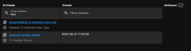

Devem testar a execução do flow para garantir que o sensor é criado com sucesso. O sensor criado tem o nome sensor.tv_footbal_games. Para validar, podem aceder ao Developer Tools e consultar o estado do sensor anterior para garantir que os dados foram carregados com sucesso.

Sim o flow foi executado conforme mostra a imagem.
Mas o sensor não é criado…
Edita o ultimo node para ver os detalhes.
Tenho assim:
O nome do sensor deverá ser o sensor que ele cria no flow.
Refere-se a isto?
sim mas está ok.

Tentei instalar também mas a mim os unicos sensores que tenho são estes :
No NodeRed não tenho erro nenhum, e no card quando carrego num dos botões não faz nada:
Sou eu que tenho de criar estas entidades?

Sim, esse eu já criei (como mostro na foto em cima), já me aparece esse sensor. Ele não está propriamente no configuration, mas está dentro dos pakages que é a mesma coisa. Eu já o tenho criado, mas nao apresenta valor nenhum, é mesmo assim?
