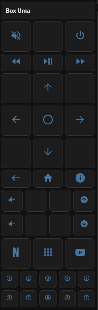

4 - Agora é altura de fazer o card. Fiz o seguinte mas confesso que ainda não está como eu gosto, tentei replicar o layout do comando.
type: vertical-stack
cards:
  - type: markdown
    content: '## Box Uma'
  - type: grid
    columns: 3
    square: true
    cards:
      - type: button
        icon: mdi:volume-off
        tap_action:
          action: call-service
          service: rest_command.box_uma_vol_mute
      - type: button
        tap_action:
          action: none
      - type: button
        icon: mdi:power
        tap_action:
          service: rest_command.box_uma_power
  - type: grid
    columns: 3
    square: false
    cards:
      - type: button
        icon: mdi:rewind
        tap_action:
          service: rest_command.box_uma_rewind
      - type: button
        icon: mdi:play-pause
        tap_action:
          service: rest_command.box_uma_play_pause
      - type: button
        icon: mdi:fast-forward
        tap_action:
          service: rest_command.box_uma_fast_forward
  - type: grid
    columns: 3
    square: true
    cards:
      - type: button
        tap_action:
          action: none
      - type: button
        icon: mdi:arrow-up
        tap_action:
          service: rest_command.box_uma_up
      - type: button
        tap_action:
          action: none
      - type: button
        icon: mdi:arrow-left
        tap_action:
          service: rest_command.box_uma_left
      - type: button
        icon: mdi:checkbox-blank-circle-outline
        tap_action:
          service: rest_command.box_uma_ok
      - type: button
        icon: mdi:arrow-right
        tap_action:
