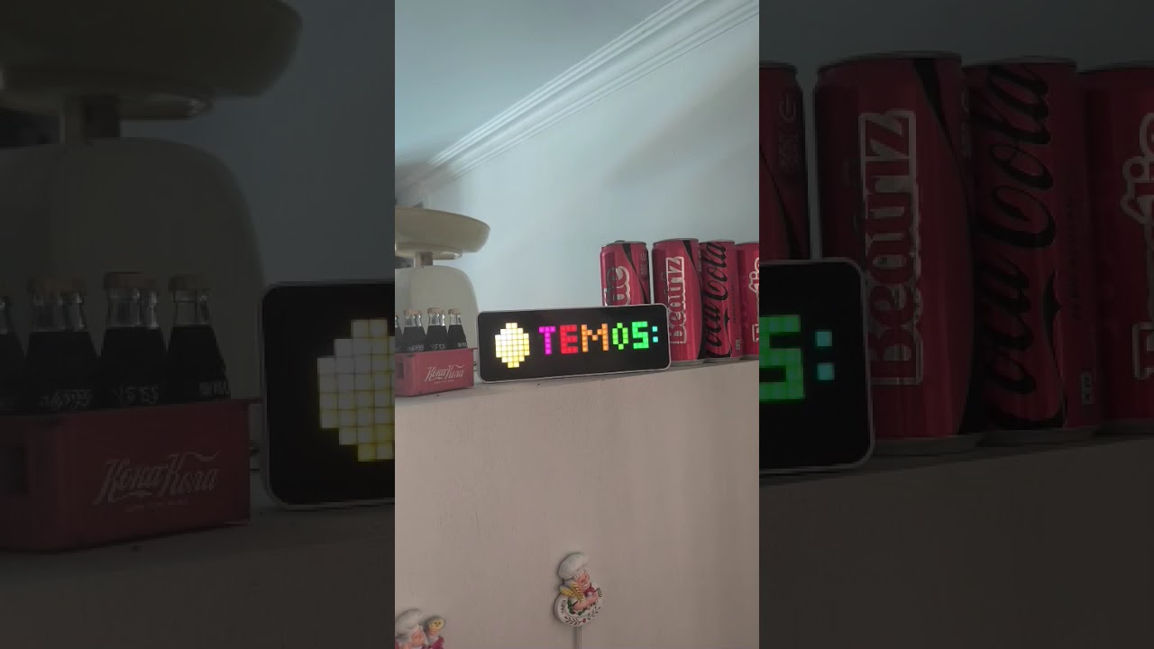

  1. Caso tenham um ulanzi eu tenho esta automação, se nao podem ignorar.
alias: Ulanzi - Loop Sensores
triggers:
  - event: start
    trigger: homeassistant
  - trigger: time_pattern
    hours: /1
actions:
  - repeat:
      while:
        - condition: template
          value_template: "true"
      sequence:
        - data:
            topic: awtrix_4d6890/notify
            payload: |
                "text": "Estado da Bateria Solar: {{ states('sensor.inverter_battery') }}%",
                "duration": 10,
                "icon": 390,
                "speed": 1,
                "repeat": -1,
                "rainbow": true
          action: mqtt.publish
        - delay:
            hours: 0
            minutes: 0
            seconds: 10
            milliseconds: 0
        - data:
            payload: |
                "text": "Consumo: {{ states('sensor.inverter_load_power') }} W",
                "duration": 10,
                "icon": 62603,
                "repeat": -1,
                "rainbow": true
        - delay:
            hours: 0
            minutes: 0
            seconds: 10
            milliseconds: 0
        - data:
            payload: |
                "text": "A produzir: {{ states('sensor.inverter_pv_power') }} W",
                "duration": 10,
                "icon": 49419,
                "repeat": -1,
                "rainbow": true
        - delay:
            hours: 0
            minutes: 0
            seconds: 10
            milliseconds: 0
        - data:
            payload: |
                "text": "Temos: {{ states('input_number.ovos') | int }} ovos",
                "duration": 10,
                "icon": 2647,
                "repeat": -1,
                "rainbow": true
        - delay:
            hours: 0
            minutes: 0
            seconds: 10
            milliseconds: 0
mode: restart
Alterem a vossa maneira , e que vos seja útil.
