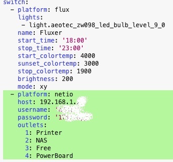

Como tenho o configuration.yaml:
#Tomada Netio by GooSe
switch:
  - platform: netio
    host: 192.168.1.32
    username: admin
    password: admin
    outlets:
      1: Free
      2: TV
      3: teste
      4: Lamp
