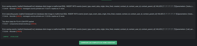

Ajuda Erro LOG - Não sei como corrigir
Ajuda em erros, não sei como resolver.
Logger: homeassistant.components.recorder
Source: components/recorder/__init__.py:516
Integration: Recorder (documentation, issues)
First occurred: 17:32:00 (1 occurrences)
Last logged: 17:32:00
Error saving events: (sqlite3.DatabaseError) database disk image is malformed [SQL: INSERT INTO events (event_type, event_data, origin, time_fired, created, context_id, context_user_id, context_parent_id) VALUES (?, ?, ?, ?, ?, ?, ?, ?)] [parameters: ('call_service', '{"domain": "system_log", "service": "clear", "service_data": {}}', 'LOCAL', '2020-12-05 17:31:59.034429', '2020-12-05 17:31:59.034429', '9a846c81218bea6f524c736c2048f511', '520bf80cd1d74d1ea35814792996ec5b', None)] (Background on this error at: http://sqlalche.me/e/13/4xp6)
Source: components/recorder/__init__.py:518
First occurred: 17:41:12 (1 occurrences)
Last logged: 17:41:12
Error executing query: (sqlite3.DatabaseError) database disk image is malformed [SQL: INSERT INTO events (event_type, event_data, origin, time_fired, created, context_id, context_user_id, context_parent_id) VALUES (?, ?, ?, ?, ?, ?, ?, ?)] [parameters: ('call_service', '{"domain": "system_log", "service": "clear", "service_data": {}}', 'LOCAL', '2020-12-05 17:41:11.019374', '2020-12-05 17:41:11.019374', '8da2a4bce1253cafc9e1476256b64aaa', '520bf80cd1d74d1ea35814792996ec5b', None)] (Background on this error at: http://sqlalche.me/e/13/4xp6)
apaga a base de dados e o erro desaprece.
perde-se o histórico com ao apagar a bd
Como faço isso ?
Tem o samba instalado com add-on?
se sim e entrar no HA via samba, aceder à diretoria config e apagar o ficheiro.
Acedendo à pasta /config do HA, apagas o ficheiro home-assistant_v2.db
